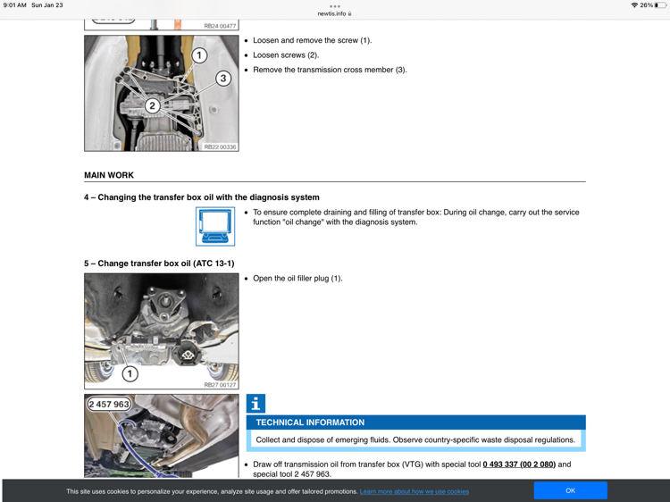

You're supposed to use ISTA to do it, it cycles the transfer case solenoids to empty it out completely and will tell you what to do after you fill it and at what temperature and stuff like that.

Interesting. I'm not doubting you, but I'm just curious where you got this information. I've never encountered a BMW transfer case that requires cycling solenoids to drain fluid. You can also always replace the same volume you remove, and while it may not be all of it, it would still be beneficial.
Well, personally haven't done it yet, since I don't have my car, and since I don't have a car to physically scan I can't tell you what is in the service plan, but here ya go. (per the bmw service manual). If I get one of these at my shop I can post exactly what the situation is and if it's needed or not. I was just guessing considering usually bmw just say drain it and fill it. but for example on the front diff it says DONT fill it until it starts leaking out the fill plug because that's considered over filled, you have to use exactly 600ml of fluid.
cant post pics... https://ibb.co/82rKm1M https://ibb.co/rf5KJgk https://ibb.co/xzcsxhx

Yep, had to use ISTA, the program will tell you what to do next.

ISTA+ is required. Procedures for Front, Rear, and Xfer Case attached.
